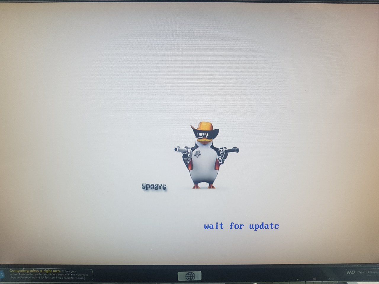

The problem is when the board is powering up, a TUX cowboy image appear with the legend: "Wait for update". After an hour an a half, nothing happens and the image remains there.
Tux cowboy
Is that normal? According to the wiki an selection screen must appear when you use the e-flasher, right?
What should I do?
Thanks in advance.
I finally solved the issue. I started over again, but this time I use the official SD card formatter and copy the image again and this time it worked.
