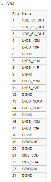

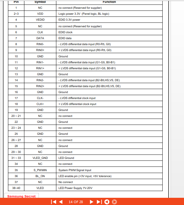

How can I connect to LCD Panel through the LVDS port with NanoPc-T3+ board?
Both of Device ( NanoPC And LCD Panel) Support LVDS but LCD Panel is 40 pin Port and NanoPC is 24 pin port.

LCD Panel Data Sheet : https://kavirelectronic.ir/eshop/index.php?controller=attachment&id_attachment=42
I confused the comparison
NanoPc lvds port:
LCD LVDS Port:
Why not just use the FriendlyArm 10.1" LCD as it will just work out of the box? If you go with this one, you will need to make an adapter and handle the backlight and the fact that the LVDS from the NanoPC is 24 bit but you panel is only 18bit means you will have a bit of work with register programming to get it working.
