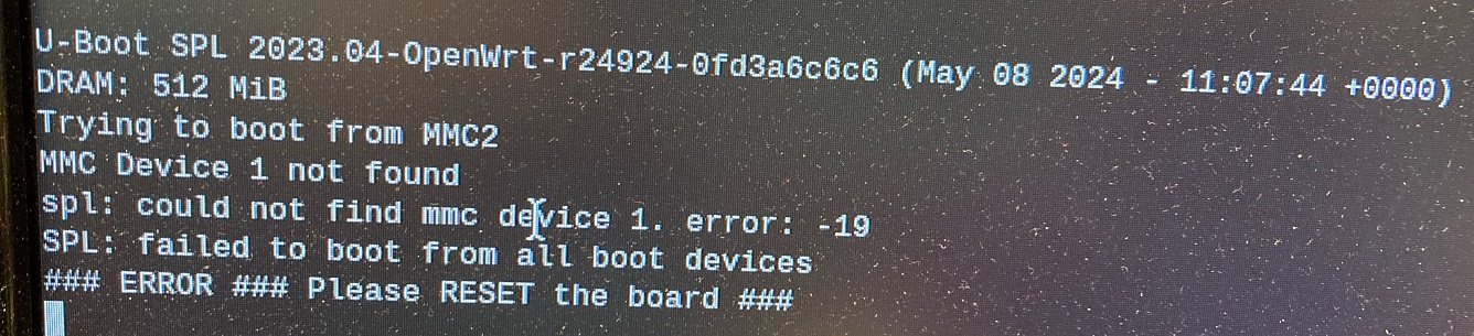

After trying flashing compiled U-boot and openwrt kernel using SD-card image it is not possible to boot from eMMC anymore. I have tried several guides, no one fits properly, and this is situation the board is right now (see the pic). Seems like it starts with MMC2 (eMMC), and eMMC is having hardcoded link into the SD-card (MMC1 - MMC device 1). I can't get where it is - in the board's boot loader or something is in the U-boot compiled within the openwrt.

If I put my compiled U-boot image into eMMC boot partition 1 is shows the picture below if no SD-card with image is inserted.
Image (14).jpg (229.07 KiB) Viewed 20626 times
