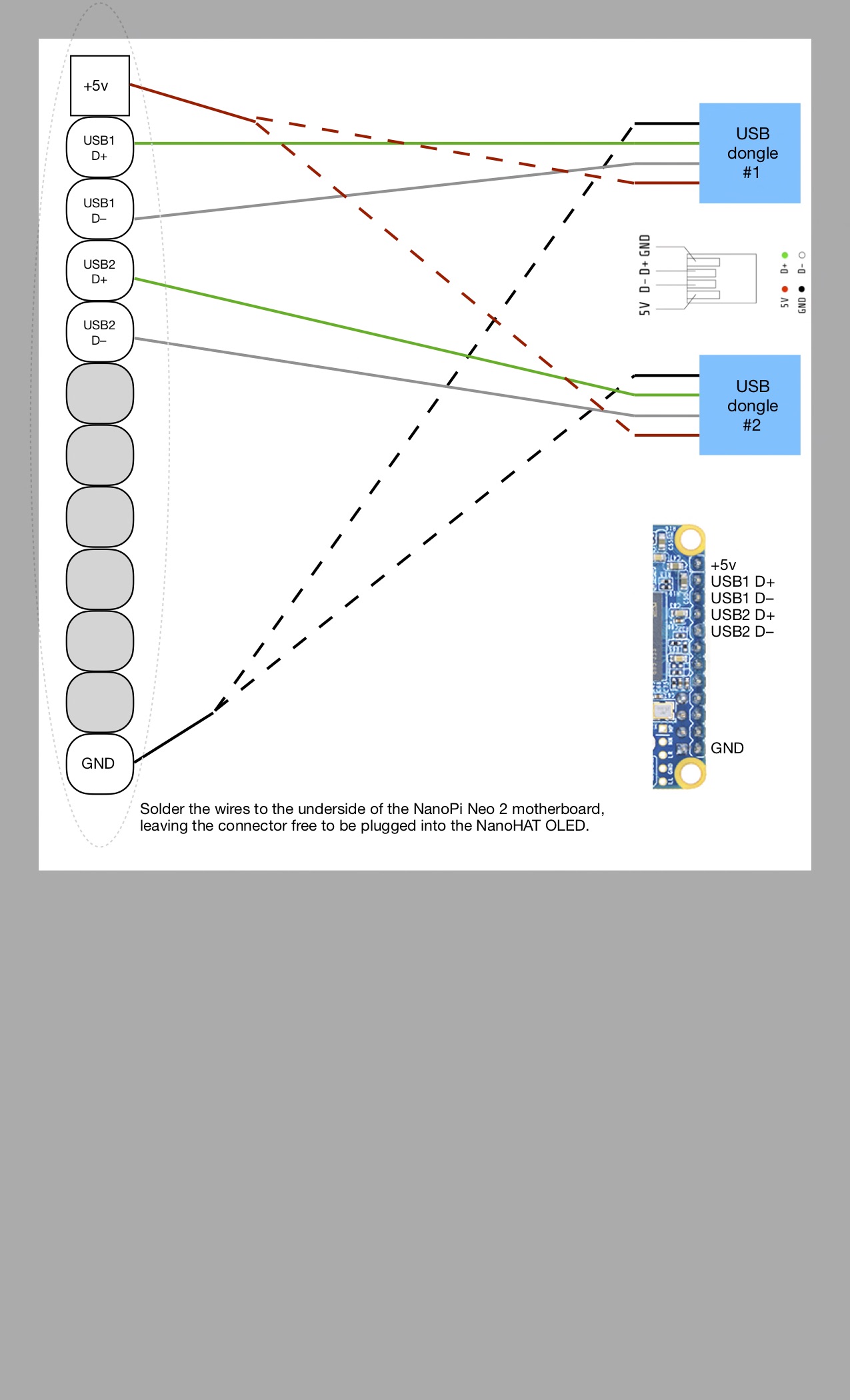

I plan to solder two additional USB devices to the NanoPi Neo2 board via the underside of the unused USB port pins (1-5 on the single-row pins?). This will work if those pins aren’t being useful by the NanoHat OLED, which will be connected to the board by the two sets of pins (single-row and double-row).
Does the NanoHat OLED use the USB pins?
I could solder to the external USB port infernally, but I would rather use the two unused USB ports/wires (if they indeed are unused).

Thank you. I missed that part of the Wiki.
I'll give this a go & see what happens. :)
Well, it worked. I attached two field-stripped USB devices to the NanoHat OLED, plugged it into a NanoPi motherboard, and enjoyed access to the two devices. Yay. I'll put together a tutorial someday.
