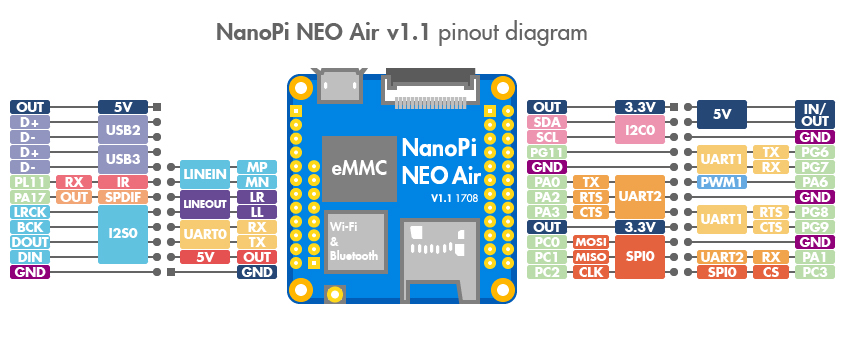

I was wondering, is there any way to power up the NanoPi Air directly through on board wiring from a 5V3A regulator? without using the microusb or otg?

take a look at the upper right pins for 5v in/out and gnd at the attached picture.
there you can power the NanoPi Air via the pins :)
Also you can read additional informations in the Wiki about the NanoPi AIr:
http://wiki.friendlyarm.com/wiki/index. ... Pi_NEO_Air
