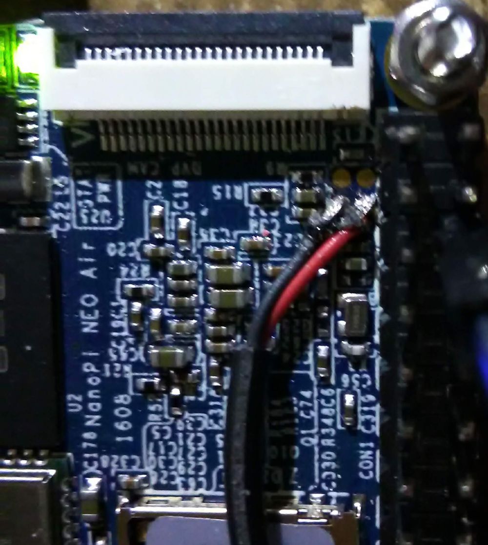

I solder wires to 2 of the 4 pads on this small board. I test for sound but get none.
Edit the "nano /etc/asound.conf" and do aplay /root/Music/test.wav and don't play any sound. I can only set the /etc/asound.conf to card 1 else the aplay will error.
What is the right setting to use the built in audio?
Got this photo of the solder job I did hard to get a good photo of it because so small.
NanoPi Neo Air audio built in2.jpg (144.3 KiB) Viewed 16609 times
Any one else do this and got the audio working?

It depends of the OS. At least on Armbian you need to enable audio codec in armbian-config -> hardware ... I am not sure its enabled by default. Also not sure it this is the case on stock images.

Try Armbian, enable codec (that's support for analog audio which you are trying to use) and it might just work. Haven't tried on this board but if it is wired properly, there are no reasons why it doesn't work.

Yes Audio (in and out) are working on nanopi neo air v1. I got mainly software problems to make it working on my specific setup (need to patch the kernel and configure alsa). You may find some info I wrote at https://github.com/auto3000/meta-nanopi-neo-air
