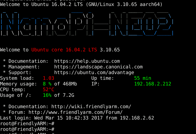

The new ROM would be ready within one month. We take some feature/advantage from Armbian and Raspbian, one like this:):
New ROM's login Welcome
