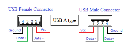

I think you should check step 1. because all other steps seem to be right.
Do you got the right colors at the cable (black, red, green and white?)
Did you think about that the female header is in the other pinout-direction as the male header (see attachment)?
Thanks for the prompt reply,
I've revisited step 1 and checked the cable continuity, confirmed that there were no breaks in the cable.
1. Reconnected as follows
USB pin 1 -- Red --- Nanopi pin 1 ---- VDD5V
USB pin 2 -- Green --- Nanopi pin 2 ---- USB-DP1 (D+)
USB pin 3 -- White --- Nanopi pin 3 ---- USB-DM1 (D-)
USB pin 4 -- Black --- Nanopi pin 12 ---- GND
2. powered up Nanopi again
3. ran lsusb -- the USB device appeared in list (strange it didnt appeared before but now its OK)
4. ran blkid to check if automounted -- /dev/sda appeared
5. reconnected as follows (while powered)
USB pin 2 -- Green --- Nanopi pin 4 ---- USB-DP2 (D+)
USB pin 3 -- White --- Nanopi pin 5 ---- USB-DM2 (D-)
6. repeat steps 3 and 4 -- USB device appeared in list, /dev/sda
7. plugged a USB WiFi dongle on Nanopi's original USB port
8. ran nmtui to enable WiFi connection and activate it
9. ran ifconfig to confirm WiFi IP address
10. shutdown and remove LAN cable from Ethernet port
11. powered on the nanopi
12. SSH nanopi using WiFi IP address --> success
Reviewing all of this, the problem may have been caused by poor electrical connection on the D+ side, there was some contaminant inside the female pin header during continuity test.
With this my original requirements have been met.
Thanks again for the replies. :D
