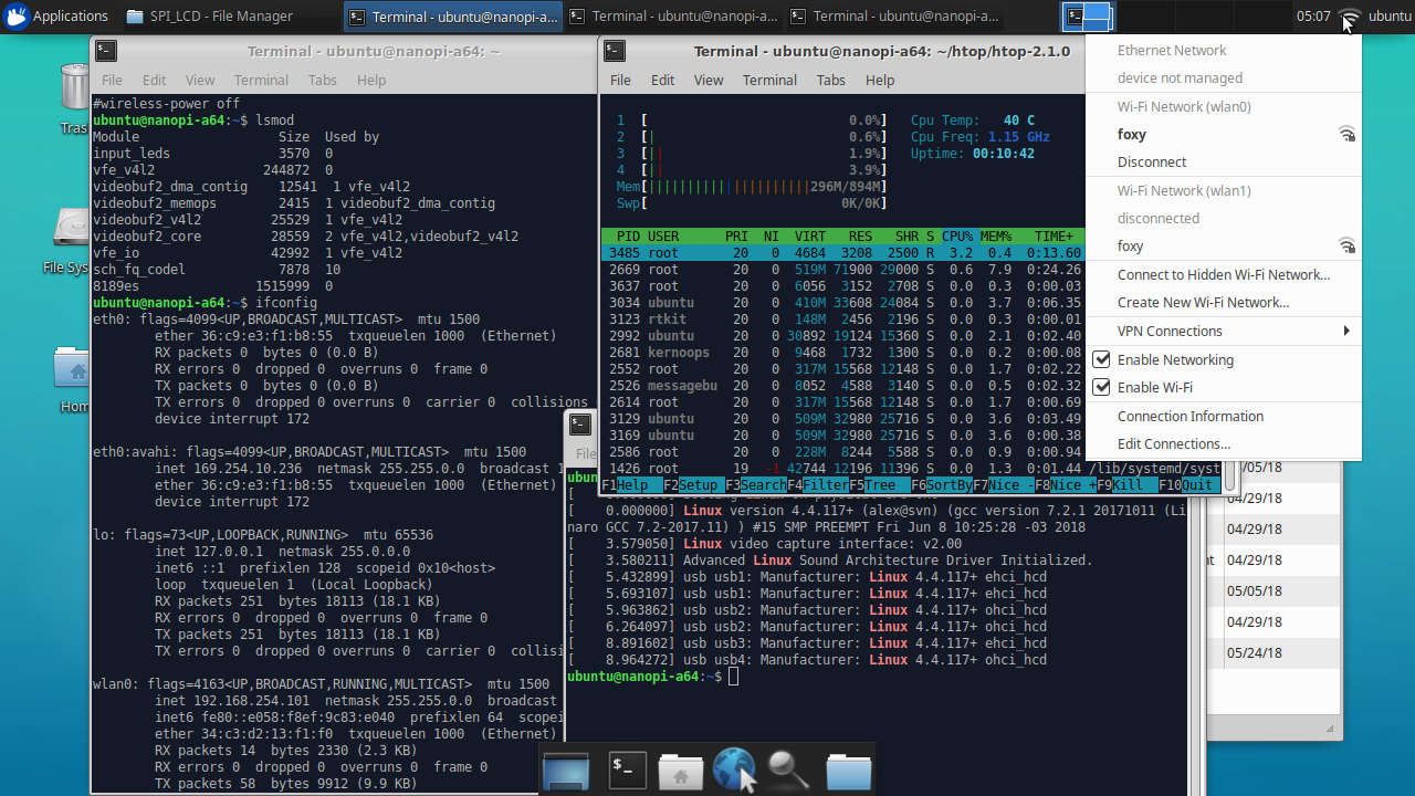

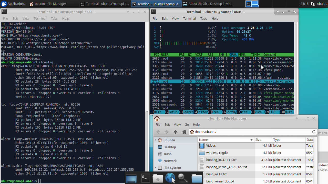

I have been evaluating some modern kernel for the A64 and while mainline kernel 4.17 isn't ready i worked on linux 4.4.111 with bionic and xubuntu and gave it a try.
This is not BSP (although based on) but rather u-boot passing a Flattened DTB to the patched kernel to give some idea about the progress and what works so far:
* Gbps
* Hdmi
* hdmi sound
* DVFS
Need some fix:
* RTL8189ETV sometimes works, still unusable.

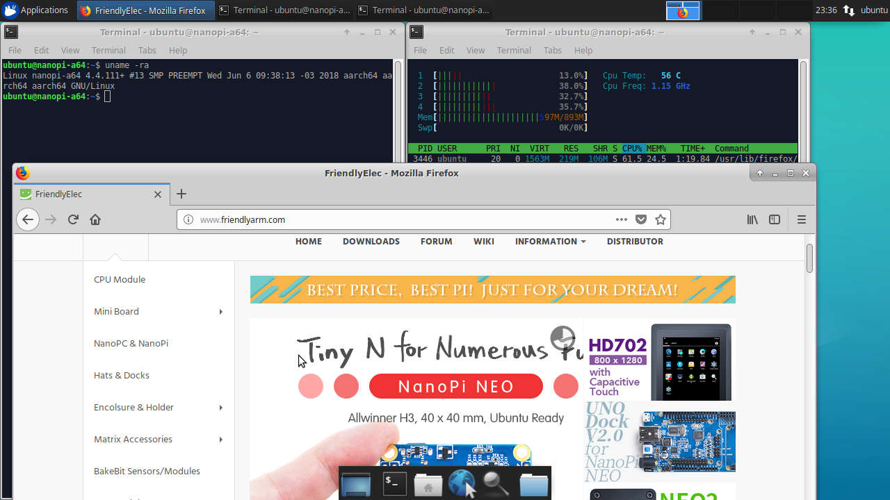

As you can see, firefox is memory hungry application, add this to the bionic and 1 GB mem is almost full.
[attachment=0]a64_kernel_4.4.111_2.jpg[/attachment]
[attachment=1]a64_kernel_4.4.111+.jpg[/attachment]
