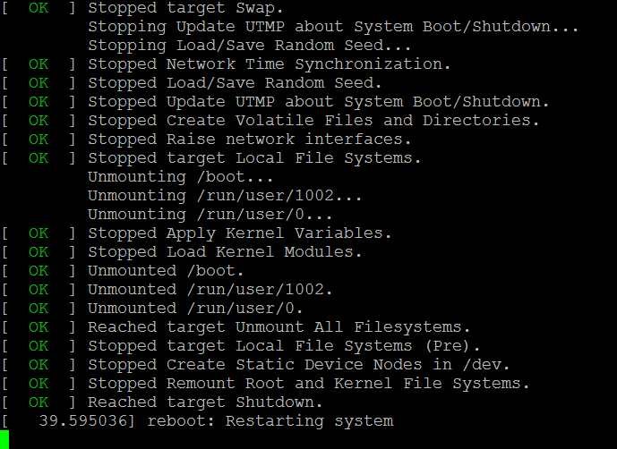

reboot issue
after reboot command:
On armbian the same
Expected that it will boot then, but nothing happening after that.
It will boot just after power off\on
Is it just on mine board or everyone has the same ?

storm wrote:
I've checked, on armbian (both debian and ubuntu) latest, for now, upgraded and so on, the result is the same.
System is not going up after reboot.
Debian and Ubuntu are identical in a kernel and u-boot, where is the source of this issue.

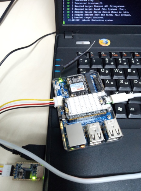

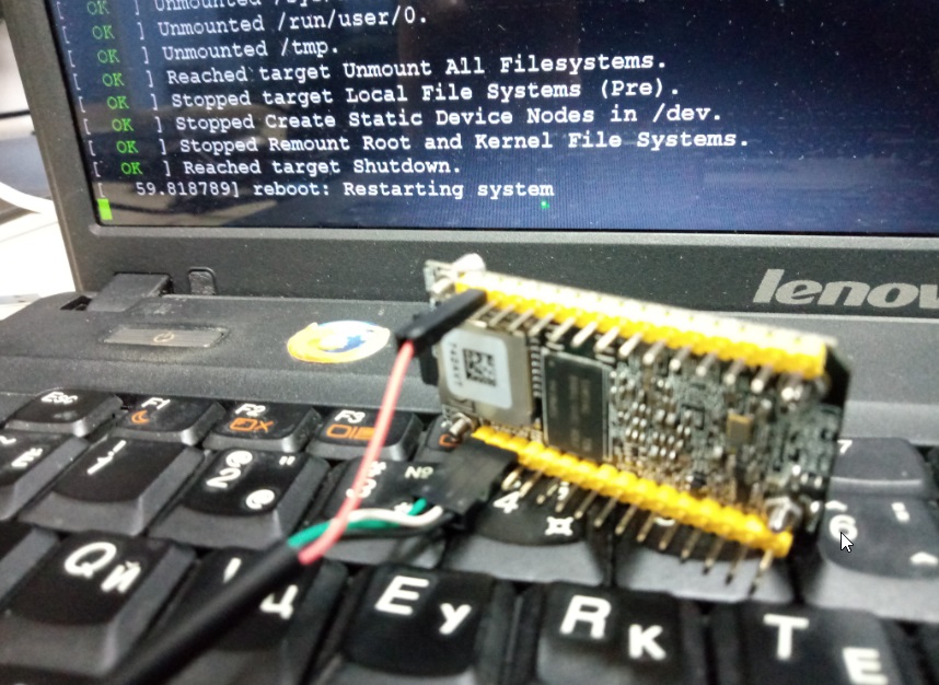

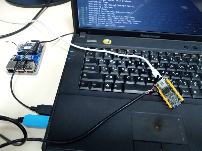

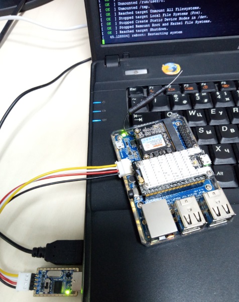

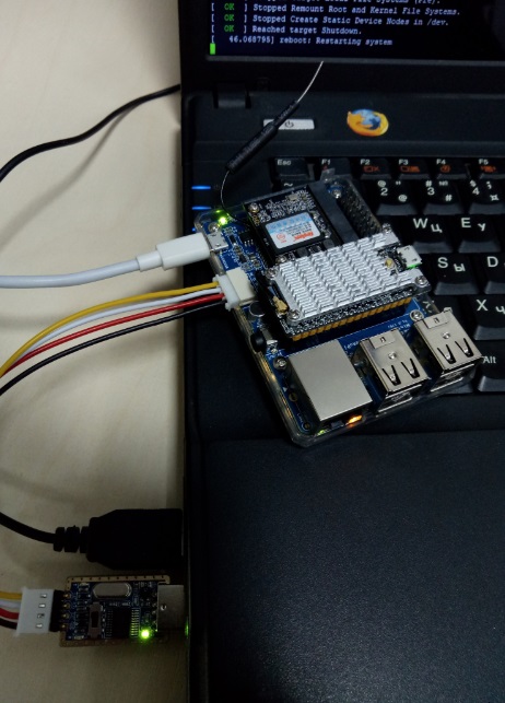

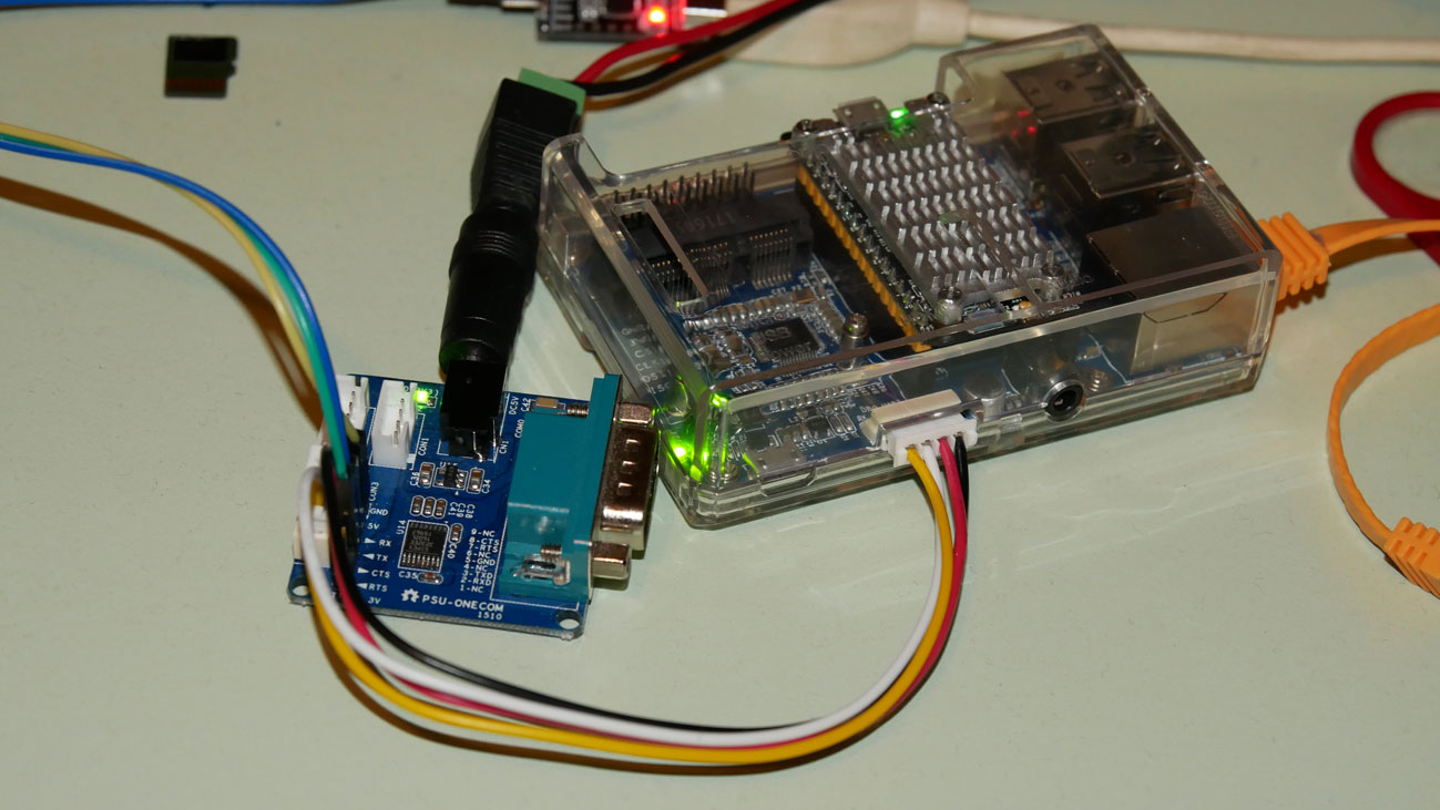

I actually tested and it worked for me, Duo without a shield. Have you been using it with shield board? It must depend on the powering method used. There are few.
It reboots properly for me, also with a shield, powered this way: (bootlogs)
Tried all possible combinations.
If yours reboots well, becomes, mine is buggy.
Will order another one.
Thanks.

[ OK ] Started Daily apt upgrade and clean activities.
[ OK ] Reached target Timers.
Starting LSB: Advanced IEEE 802.11 management daemon...
Starting /etc/rc.local Compatibility...
Starting LSB: Start NTP daemon...
Starting LSB: disk temperature monitoring daemon...
[ OK ] Started LSB: Advanced IEEE 802.11 management daemon.
[ OK ] Started /etc/rc.local Compatibility.
[ OK ] Started LSB: disk temperature monitoring daemon.
[ OK ] Started LSB: Armbian gathering hardware information.
[ OK ] Started Serial Getty on ttyS0.
[ OK ] Started Getty on tty1.
[ OK ] Started Serial Getty on ttyGS0.
[ OK ] Reached target Login Prompts.
[ OK ] Started LSB: Start NTP daemon.
[ OK ] Reached target Multi-User System.
[ OK ] Reached target Graphical Interface.
Starting Update UTMP about System Runlevel Changes...
[ OK ] Started Update UTMP about System Runlevel Changes.
Ubuntu 16.04.3 LTS nanopiduo ttyS0
nanopiduo login: root
Password:
Last login: Mon Jan 29 06:53:20 UTC 2018 on ttyS0
root@nanopiduo:~# reboot
[ OK ] Stopped target Gra Stopping Session 2 of user root.
[ OK ] Stopped target Timers.
[ OK ] Stopped Daily apt upgrade and clean activities.
[ OK ] Stopped Daily Cleanup of Temporary Directories.
Stopping User Manager for UID 0...
[ OK ] Closed Load/Save RF Kill Switch Status /dev/rfkill Watch.
[ OK ] Stopped Daily apt download activities.
[ OK ] Stopped target System Time Synchronized.
[ OK ] Stopped target Multi-User System.
[ OK ] Stopped target Login Prompts.
Stopping Serial Getty on ttyGS0...
Stopping LSB: Armbian gathering hardware information...
Stopping LSB: disk temperature monitoring daemon...
Stopping OpenBSD Secure Shell server...
Stopping Unattended Upgrades Shutdown...
Stopping LSB: Start NTP daemon...
Stopping Initializes zram swaping...
Stopping LSB: Set sysfs variables from /etc/sysfs.conf...
Stopping System Logging Service...
Stopping LSB: Start/stop sysstat's sadc...
Stopping Regular background program processing daemon...
Stopping LSB: Advanced IEEE 802.11 management daemon...
Stopping Getty on tty1...
Stopping Authenticate and Authorize Users to Run Privileged Tasks...
Stopping Serial Getty on ttyS0...
[ OK ] Deactivated swap /dev/zram1.
[ OK ] Deactivated swap /dev/zram0.
[ OK ] Deactivated swap /dev/zram2.
[ OK ] Stopped Regular background program processing daemon.
[ OK ] Stopped System Logging Service.
[ OK ] Stopped OpenBSD Secure Shell server.
[ OK ] Stopped Hostname Service.
[ OK ] Stopped Authenticate and Authorize Users to Run Privileged Tasks.
[ OK ] Stopped Serial Getty on ttyS0.
[ OK ] Stopped Getty on tty1.
[ OK ] Stopped Serial Getty on ttyGS0.
[ OK ] Stopped User Manager for UID 0.
[ OK ] Stopped Session 2 of user root.
[ OK ] Stopped LSB: Armbian gathering hardware information.
[ OK ] Stopped Unattended Upgrades Shutdown.
[ OK ] Stopped Initializes zram swaping.
[ OK ] Stopped LSB: Advanced IEEE 802.11 management daemon.
[ OK ] Deactivated swap /dev/zram3.
[ OK ] Stopped LSB: disk temperature monitoring daemon.
[ OK ] Stopped LSB: Start NTP daemon.
[ OK ] Stopped LSB: Set sysfs variables from /etc/sysfs.conf.
[ OK ] Stopped LSB: Start/stop sysstat's sadc.
Stopping LSB: set CPUFreq kernel parameters...
[ OK ] Removed slice User Slice of root.
Stopping Login Service...
[ OK ] Removed slice system-getty.slice.
Stopping Permit User Sessions...
[ OK ] Removed slice system-serial\x2dgetty.slice.
[ OK ] Stopped /etc/rc.local Compatibility.
[ OK ] Stopped target Network is Online.
[ OK ] Stopped Network Manager Wait Online.
[ OK ] Stopped target Network.
Stopping WPA supplicant...
Stopping Network Manager...
Stopping Raise network interfaces...
[ OK ] Stopped Login Service.
[ OK ] Stopped Permit User Sessions.
[ OK ] Stopped WPA supplicant.
[ OK ] Stopped Network Manager.
[ OK ] Stopped LSB: set CPUFreq kernel parameters.
Stopping LSB: Load kernel modules needed to enable cpufreq scaling...
Stopping D-Bus System Message Bus...
[ OK ] Stopped Raise network interfaces.
[ OK ] Stopped D-Bus System Message Bus.
[ OK ] Stopped LSB: Load kernel modules needed to enable cpufreq scaling.
[ OK ] Stopped target Remote File Systems.
[ OK ] Stopped target Remote File Systems (Pre).
[ OK ] Stopped target Basic System.
[ OK ] Stopped target Slices.
[ OK ] Removed slice User and Session Slice.
[ OK ] Stopped target Sockets.
[ OK ] Closed Syslog Socket.
[ OK ] Stopped target Paths.
[ OK ] Stopped Dispatch Password Requests to Console Directory Watch.
[ OK ] Stopped Forward Password Requests to Wall Directory Watch.
[ OK ] Closed D-Bus System Message Bus Socket.
[ OK ] Stopped target System Initialization.
[ OK ] Stopped target Swap.
Stopping Armbian enhanced Log2Ram...
Stopping Entropy daemon using the HAVEGE algorithm...
[ OK ] Stopped target Encrypted Volumes.
Stopping Restore / save the current clock...
Stopping Update UTMP about System Boot/Shutdown...
[ OK ] Stopped target Network (Pre).
[ OK ] Stopped Apply Kernel Variables.
[ OK ] Stopped Load Kernel Modules.
[ OK ] Stopped Entropy daemon using the HAVEGE algorithm.
[ OK ] Stopped Restore / save the current clock.
[ OK ] Stopped Update UTMP about System Boot/Shutdown.
[ OK ] Unmounted /var/log.
[ OK ] Stopped Create Volatile Files and Directories.
Stopping Load/Save Random Seed...
[ OK ] Unmounted /var/log.hdd.
[ OK ] Stopped Armbian enhanced Log2Ram.
[ OK ] Stopped Load/Save Random Seed.
[ OK ] Stopped target Local File Systems.
Unmounting /sys/kernel/debug/tracing...
Unmounting /run/user/0...
Unmounting /tmp...
[ OK ] Unmounted /sys/kernel/debug/tracing.
[ OK ] Unmounted /run/user/0.
[ OK ] Unmounted /tmp.
[ OK ] Reached target Unmount All Filesystems.
[ OK ] Stopped target Local File Systems (Pre).
[ OK ] Stopped Create Static Device Nodes in /dev.
[ OK ] Stopped Remount Root and Kernel File Systems.
[ OK ] Reached target Shutdown.
[ 39.758826] reboot: Restarting system
