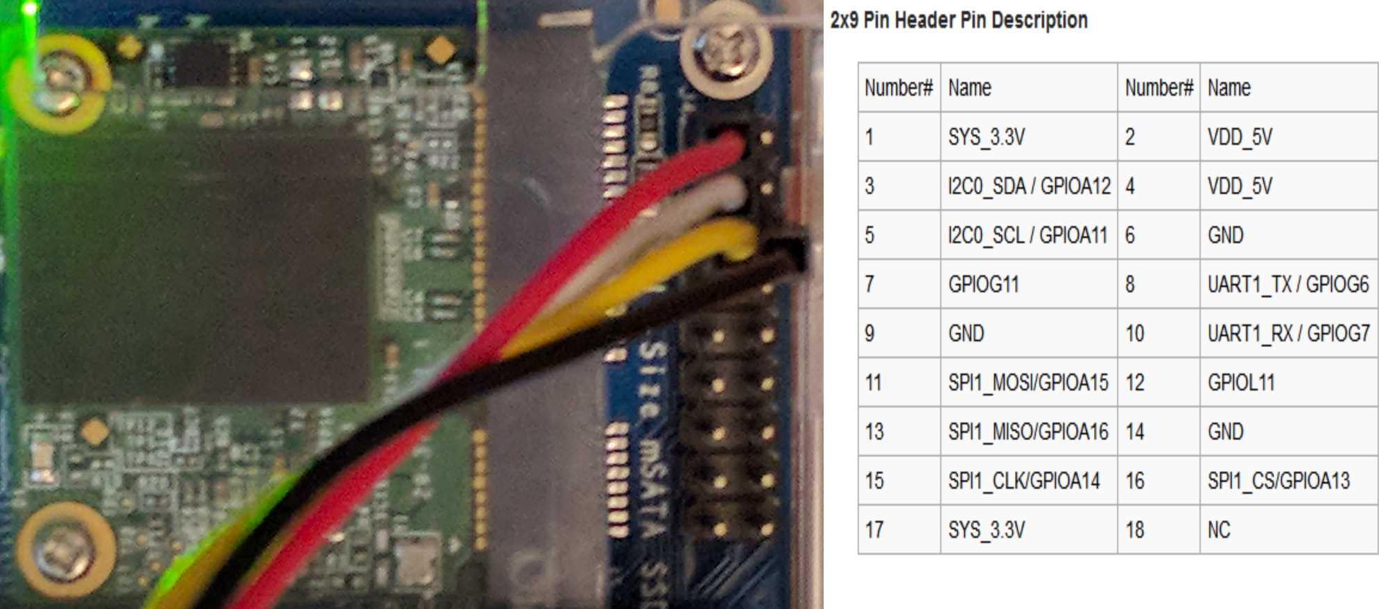

First take a look at the NanoPi Wiki, because we must know which I2C Bus we are using with the 2x9 Pin Header.
NanoPi Duo 2x9 Pin Header smaller.jpg (124.49 KiB) Viewed 28211 times
OK, we are using I2C0, this is Important to know, because in Python Scripts written for other Computer, they may using an other Bus. If I2C1 or I2C2 is addressed, we have to change the Script to I2C0.

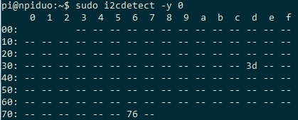

If we have installed one ore more I2C devices on our NanoPi, we can check there addresses out now.
pi@npiduo:~$ sudo i2cdetect -y 0
(Address 76 is a BME280 and address 3d is a Char OLED.)
