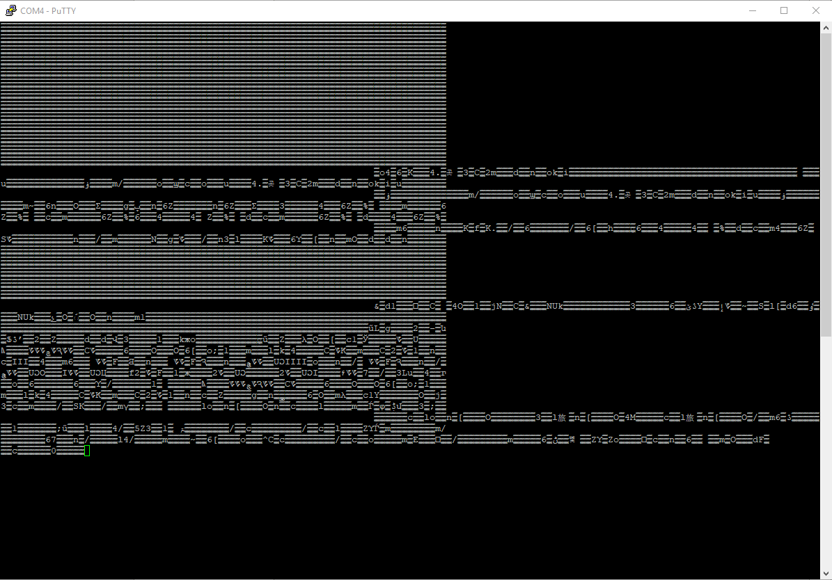

I'm trying to use the debug UART of the Nano Pi M4.
I connect via PuTTy. I set correct COM number, speed 1500000, but all I see is garbage.
I was expecting the log of the system boot and be able to issue some commands after boot sequence is complete.
I installed latest FriendlyDesktop on SD card.
I'm not using the counterfeit Prolific USB-to-serial, the chip on my converter is PL2303TA (Windows 10 drivers work with this one with no need to downgrade).
What else can I do?
When I tried to change the speed to e.g. 1100000, I could type in all of the numbers 1-9, and top keyboard row letters (with occasional garbage).

Where did you get the information about the speed of 1.500.000 or 1.100.000 Baud for the serial port?
I couldnt find the baudrate at http://wiki.friendlyarm.com/wiki/index.php/NanoPi_M4
Normally - the NanoPi and other boards Board I know - does use 115.200 Baud for the serial port.
The only other board was a Orane Pi i96 with 921.600 Baud (strange).
So - first try 115200 Baud and maybe XON/XOFF has handshake.
1.100.000 was just my experimenting.
the 1.500.000 is right on the page you put a link to:
It says:
Debug: one Debug UART, 4 Pin 2.54mm header, 3V level, 1500000bps
