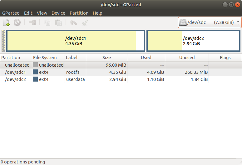

Yes, I think too. I suspect that the first "unused" memory area contains raw data :

Ok I found the solution! Based on provided scripts from FriendlyARM (sd-fuse_rk3399), I made this script to flash parameters, kernel and dtb files only into the first raw partition.
I copied usefull files next to my script :
- kernel.img (kernel binary)
- resource.img (dtb, logo, etc)
- param4sd.txt (from sd-fuse_rk3399 repo)
- parameter.txt (from sd-fuse_rk3399 repo)
- partmap.txt (from sd-fuse_rk3399 repo)
- sd_update (from sd-fuse_rk3399 repo)
