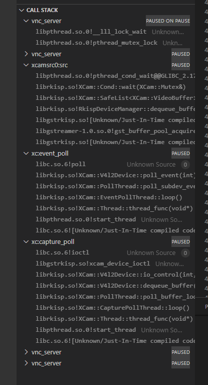

I am just got a SOM-RK3399v2 Dev Kit and install the friendlycore-bionic-4.4-arm64-20200623. When I use the HDMI-IN with rkisp as input I found that it'll hang in gstreamer restarting.
Here is my gstreamer pipeline:
"rkisp device=/dev/video0 io-mode=1 ! capsfilter caps=\"video/x-raw,format=NV12,video/x-raw,format=NV12,framerate=30/1,width=1920,height=1080\" ! appsink"
And here is the stack trace of relative thread:
