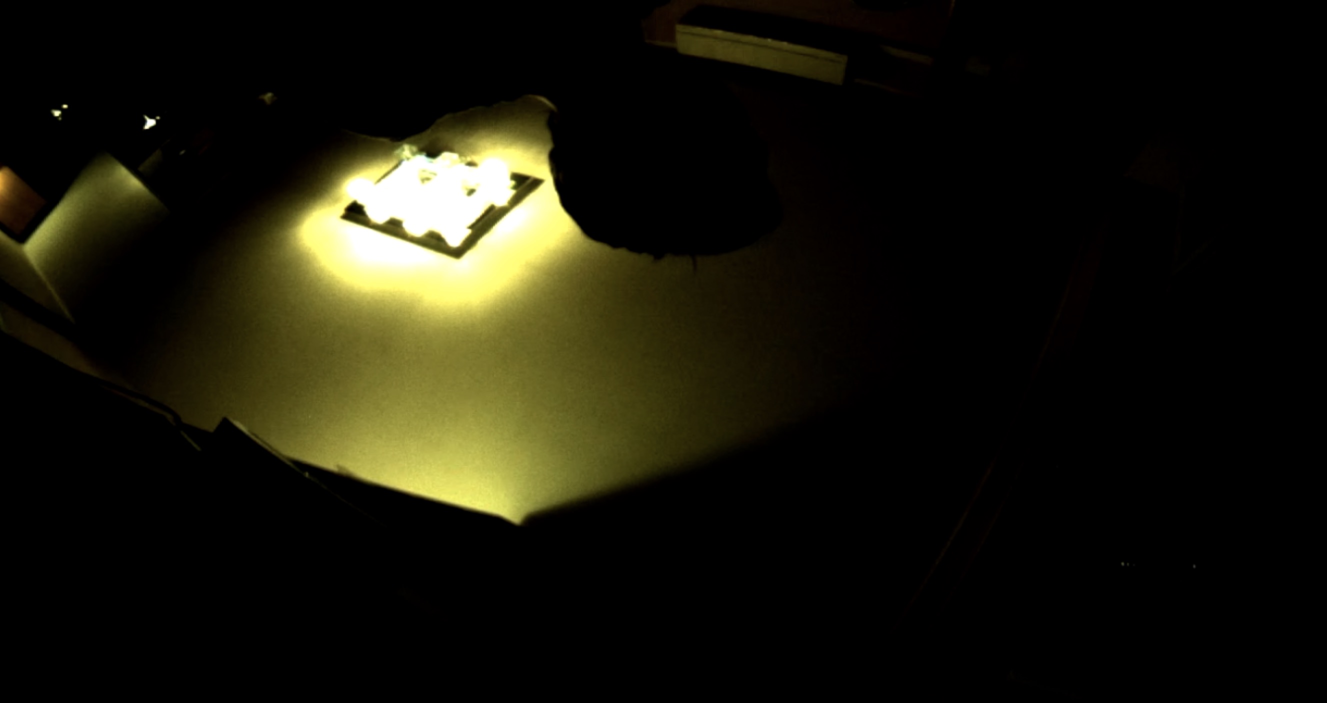

We're working on making OV5647 camera (15 pin CSI cable, https://www.waveshare.com/rpi-camera-b.htm) to work with SOM-RK3399v2. We managed to adjust device tree layer and the camera works and we can see the image.
However, the image is quite dark and greenish. After searching we identified that this can be related to missing iq file.
During the streaming start process we get:
XCAM ERROR rkisp_control_loop_impl.cpp:166: can't access iq file /etc/cam_iq/ov5647.xml
Here is the example of the image / video quality we have:
I suspect this can be resolved with adding iq file ov5647.xml to /etc/cam_iq. However, this file is missing everywhere. Could anyone suggest the solution please?

You can try this one, taken from FE OS image.
Care to explain how you took the jpg image?
All camera IQ files comes from RockChip camera_engine_rkisp repository (which was removed from public access in summer of 2020) - and it's no OV5647 IQ files. OV5648 is nearest. It's also important to use same version of IQ files with RkISP1 driver.

Thanks for the suggestion Lex! Unfortunately, this file belongs to different RkISP version and it complains about versions mismatch when initialising the stream. Changing version in xml file to required removes the warning but the quality even worse.
I(acidentely) made a backup of this https://github.com/ayaromenok/camera_engine_rkisp RkISP repo - maybe you can find some useful info in source code.
ayaromenok, many thanks for sharing the link! I'll be able to test with OV5648 xml for OV5647 and then report back here about the results.

BTW - Rockchip restored repo https://github.com/rockchip-linux/camera_engine_rkisp (it wasn't there from Sep 2020 to at least Jan 2021) - so looks like it's don't have any new commits during this time (and same as my copy - at least IQ files use 1.5 version;) ).
PS:As I understand, in newest RK chips they use a new version of ISP, which may required a new driver - so don't expect a lot of updates in RkISP1 repo
