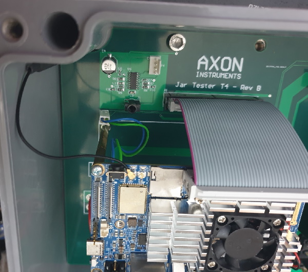

Yeah I built in a header to the board so I have the power switch able to be accessed, but only in "last resort" mode, ideally. Honestly I really needed it to be automated when that 12v "accessory" voltage initiates.

Exactly. It seems we've both encountered the same problem. Since I have dozens of little arduino nanos lying around, I've decided to employ one for this application. I had some old laptop chargers that had failed in one way or another, and I decided to go scavenging for some optocouplers off of them. Bingo, found two next to each other.
I'll be utilizing the 12v switching power to (de)activate one of those optocouplers which will be connected to a pin of the arduino, which will use that signal to output high/low to the second optocoupler which will then trigger a power button press to wake/sleep the T4. I'll be fully isolating the T4 to its own system while keeping the arduino isolated, and so forth. Same scenario as you've employed. I CAD'd up a design and 3d-printed a power pack utilizing some old laptop battery cells (fully load tested for capacity and endurance - not new to that game *for sure*) which will keep everything happy, conditioned, and alive to do all of the monitoring. Used a benchtop supply to measure all current consumption and with the T4 in deep sleep, it won't be a problem at all to keep it powered on but sleeping in between uses. Perfect.
