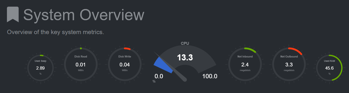

system overview
That's with all the containers running but not much load/traffic.

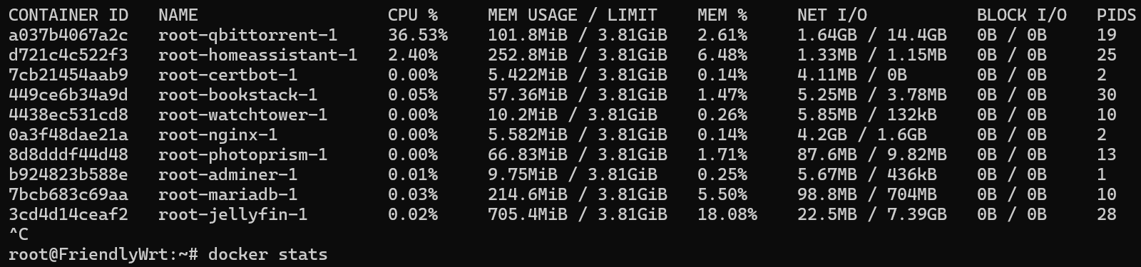

docker stats
Note: docker stats shows CPU usage per core, so it's 4x100% = 400%. Like when you index photos with Photoprism, the CPU usage might say something like 271%. And in the image above qBittorrent is using of 36.53 of 400%.

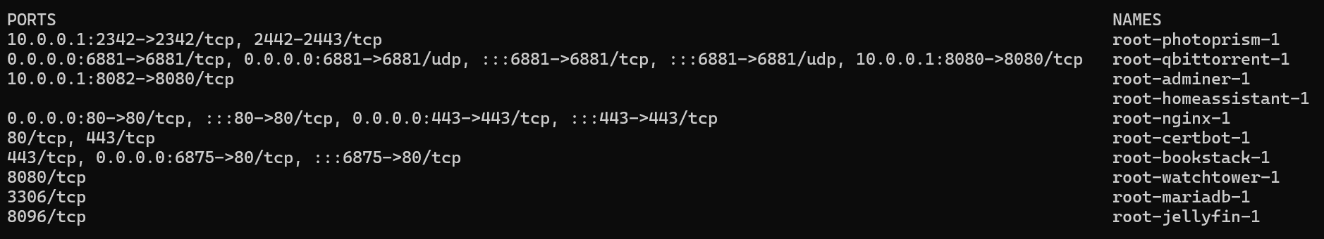

Docker forwards various ports that don't show up in Luci:
Port forwarding
You can restrict access to the LAN by specifying the NanoPi IP address in the docker-compose.yml
  adminer:
    image: adminer:latest
    restart: unless-stopped
    ports:
      - 10.0.0.1:8082:8080
    networks:
      - my-network
This can be useful if you don't want the login accessible over the internet. For example, if you don't need access over the internet or for services that don't support MFA.
