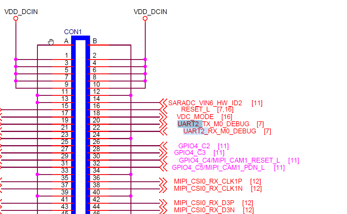

    3. I cannot properly see the connections in the schematic, nor do I have any documents showing the inner UART diagrams. So without that CPU Reference Manual you can't know how the clock is used for the UART.
