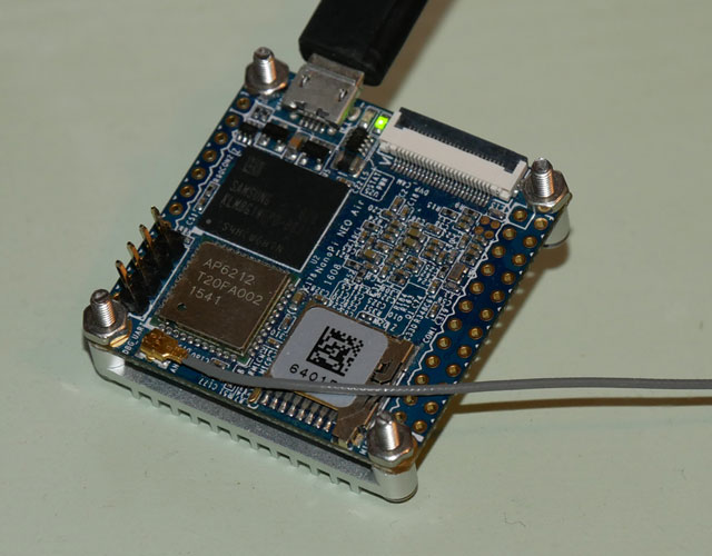

I have a NanoPi Neo Air (Allwinner H3 SoC) with onboard wifi and a serial interface. Unfortunately during some late hour hacking I managed to accidentally connect 5V onto its TX pin, I think effectively screwing up its UART0. I can no longer connect to it via a USB to TTL Serial cable (https://www.adafruit.com/product/954)
I think the SoC still seems to be working, I've flashed an ARM linux (Dietpi) to an SD card and when I powered on the Nano Pi Neo Air, it seems to have successfully expanded its filesystem.
With UART0 most probably dead, I wonder whether UART1 and UART2 would still work. Connecting a working USB/TTL serial cable to the board did not produce any output, my guess is that it needs to be enabled for the boot process.
As I don't have another Allwinner H3 board available at the moment (shipping takes weeks for us Europeans to arrive) I wonder if there's a way for me to enable UART1 and UART2 during boot. Did anyone manage to do this?

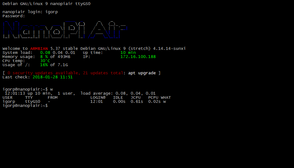

With Armbian:
https://dl.armbian.com/nanopiair/archiv ... 4.14.15.7z
Bootlog: http://ix.io/EO6
You can log in via microUSB serial. Just plug it to your USB port and a serial device will pop up on your host computer. It's not serial at boot time but you can login when system is up. Enabled by default.
ps. Dietpi is only a crippled repack of Armbian.

Yes, but I also made a small mistake which prevented this working :( I manually enable USB OTG port while testing (within armbian-config), console popped up and forget about that. Now, this is fixed and the actual download image was tested - images at download were replaced, also for NanoPi DUO with the same problem. I don't know how this looks on MAC (USB3 port is recommended for powering, but USB2 will probably also work), but this way it looks on windows:
You can log in via microUSB serial. Just plug it to your USB port and a serial device will pop up on your host computer. It's not serial at boot time but you can log in when a system is up. Enabled by default.
