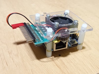

1. Install battery

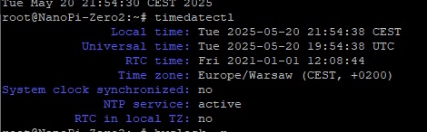

4. RTC before:

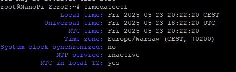

8. RTC after
9. Overview image
